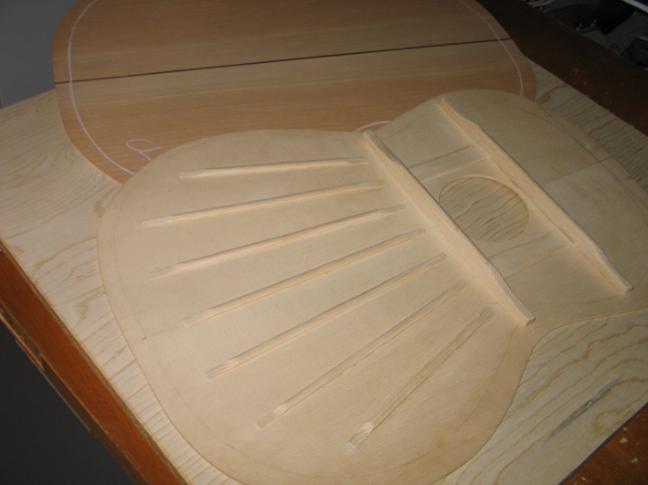

I'm currently building a Flamenco guitar based on Santos Herndandez 1933 Plans. I started in mid-August, but for now I can only work on the guitar on week-ends, thanks to university.
Here's a shot, will a lot of dust mind you , of my soundboard bracings. I'll be bracing the back next week-end if I have enough time.

Alexandre, looks like you got the hang of it, neat bracing! You're off to a really good start my friend!
What kind of glue did you use? Titebond or Hot hide glue?

[QUOTE=Serge Poirier] Alexandre, looks like you got the hang of it, neat bracing! You're off to a really good start my friend!
Serge[/QUOTE]
I used fish glue actually :) Some people mentionned it on a flamenco forum so I thought I couldn't be wrong with it.
But I don't know much about wood glues, especially for guitarmaking... any difference on tone?
PostPosted: Wed Sep 13, 2006 1:43 pm
HHG and the fish glue you used are the most seeked since they don't creep and supposedly help transfer the sound better but i'm not an expert on wood glues either, i used regular carpenter's glue and HHG on my no 2 and i just know that my guitar sounds really good but as far as telling if the joints will hold, only time will tell!
I'll let the other pros elaborate on Titebond or any other glues :-)
